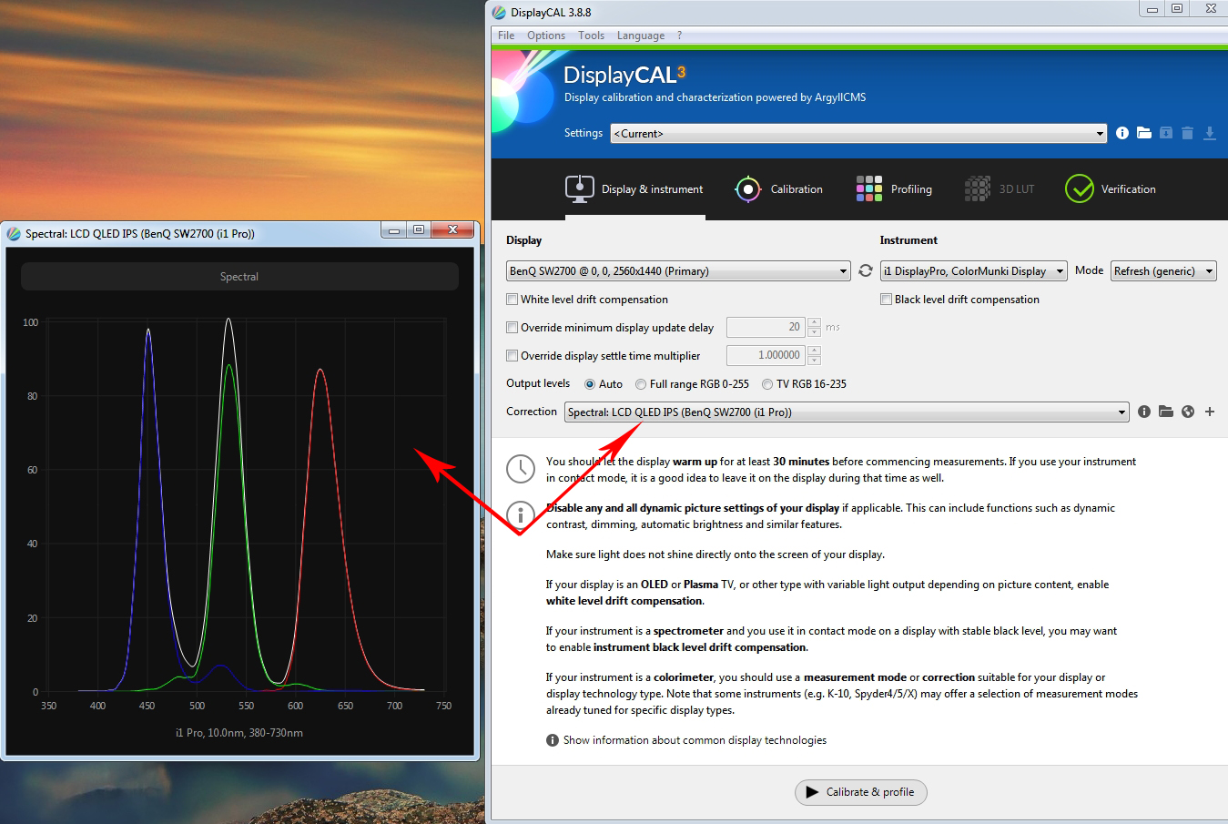

Potrzebowałbym raczej sprawdzonego, przetestowanego pliku EDR (z korekcją QLED) do programu Palette Master Element.
Plik CCSS z odpowiednią korekcją (?) już mam w DisplayCAL:
PS.
Posiadam X-Rite i1Display Pro, używasz określenia i1d3. To te same urządzenia ?

1- RGBLEDFamily_07Feb11.ccss is proven wrong for a QLED. Red channel does not match by far, so depending on your i1d3 it can result in noticeable differences.
2- Benq does not care at all
3- Yes, that CCSS looks OK. I'm happy that now there is a native gamut CCSS. In the past most of them were sRGB or AdobeRGB gamut emulations. You can see this because the other CCSS have one channel that was a mix of 2-3 of native primaries of that CCSS you ploted.
4- "i1d3" is a generic name for all the colroimeter family that uses the same HW: i1displaypro, i1displaypro OEM, color munki disolay i1display studio, NEC spectrasensor v3, the one from HP, the one from Wacom, the one from SpectraCAL, viewsonic colorbration, the one from Bassicolor... They are the same for DisplayCAL (different unlock codes -and speeds for 2 of them- but same operation by ArgyllCMS)
5- I hope that *your* particular i1d3 has a red channel sensivity stored in firmware that is close to CIE 1931 2, so error RGBLED vs QLED will be low in whitepoint. Other i1d3 may behave a little different ( +- 2 a* in white, greenish or pinkish )

No, it doesn't look OK. i1Pro has too small spectral resolution to create proper CCSS. Furthermore, even ccss done with high res spectroradiometer (FWHM 5nm or less) doesn't really work well for some mysterious reason, so paradoxically native x-rite edr's usually work better, even if they don't match the backlight SPD curve precisely.

And you are wrong...
RGBLED correction is not even close to that QLED red. That CCSS is OK for a QLED. The whole purpose of a CCSS/EDR is to compute a RGB raw i1d3 values to CIE XYZ. It's totally useless to recomend a spectral correction with is very different in some wavelength to actual device ***if we have a better one*** and ***if devis is not close to chosen observer in that wavelength region***.
For your claim to be a slightly sensible one, ANdN11 should dump his i1DisplayPro spectral sensivities (Argyll can do that, but right now I'm not sure if it is enable d by default your you should recompile it with a preprocessor directive. Only then comparing that 2 CCSS and colorimeter "observer" (spectral sensity curves) we could see if your claims do not introduce a bigger error. But this approach is out of most Benq SW owners. In the past DisplayCAL did not have a graphical SPD feature so most of them were blind when choosing a CCSS (and some of them were gamut emulation CCSS), but that does not hold right now.
The CCSS plotted by DisplayCAL that ANdN11 shows is a QLED like, at native gamut, so it's fine.
We can debate about which one we use when actual device SPD has so tiny narrow spikes that the go unnoticed with a "graphic arts" spectrophotometer (i1Pro family)... like in WLD PFS. Do we use the one bundled with Xrite i1profiler (95% P3 multimedia withot 9x% AdobeRGB) for a WLED PFS AdobeRGB display or do we use some 3.3nm made with ArgyllCMS? IN THAT SITUATION we can apply your objections... but in the end we will be hinding display manufaturer fault regarding software support like Benq (SW240 is supposed to use that backlight) or your beloved NEC and its shameful fail called PA271Q+SV2.

Sorry, AndN11, I cannot find that CCSS in your screenshot in displayCAL database:
https://colorimetercorrections.displayc ... er4&html=1
The ones in database show AdobeRGB-like gamut emulation, yours does not show it. Would you mind to post its text contents here or upload it to pastebin.com, dopbox or another server? Just for plotting RGB led and that one.
Thanks in advance

Users who make ccss have no idea of how good it's working, because they don't have spectroradiometers to validate the results. I'm not trying to hide something, that's obvious for anyone who has access to a cheap X-Rite spetrometer, or a DisplayCAL.
CCSS correction is not related ONLY to a reference instrument that provides spectral sample, it is related to firmware spectral sensivity curves of that colorimeter. That is what you try to hide.
The difference between choosing one CCSS/EDR to another and how good/how bad is going to perform depends on firmware sensivity curves too.
If a particular instrument is extremely close to reference observer in some wavelengths, or to be precise "it's firmware says that is very close to that reference observer" the correction applied in that wavelength will be none, the overall RGB RAW to CIE XYZ matrix that you have to multiply by raw measurements will not vary if you change EDR/CCSS in that particular wavelegth region.
In the same way if there is a significative difference between "observer in firmware" and "actual reference observer" in some wavelegths region there will be huge differences in results if you choose one EDR/CCSS that is VERY different from another CCSS.
This is what you try to hide making strawmans.
Hence, if AndN11 i1d3 colorimeter is close to a near perfect CIE 1931 2º in that 600-700nm region, it will not matter if he chooses RGBLED to a community QLED CCSS, at least relative to teh amount of X and Y contributed by those wavelegth regions.
And if it is not close, a significative difference will arise. Happy to read that he sees little difference = it's colorimeter behave very good on tose wavelegths even uncorrected.
And this is not related at all to measure against a reference spectroradiometer because the huge diference uses the same RAW RGB readings from his i1d3 as source but DIFFERENT RAW RGB to CIE XYZ matrices. That is what causes such difference in XYZ coordinates.
To measure which CCSS of the two is more accurate or to see how result vary with changes in a hypotetical reference spectral sample you apply what I wrote: either you use a reference sample or add noise where you want to test how critical is that region for THAT colorimeter.
That's why your previous post is a total nonsense.
Using a RGBLED correction in a QLED IS NOT GOING TO BE BETTER just because it was taken at 1nm, it could be better if it matches actual spectralpower distribution of a QLED (which DOES NOT happen as we have seen) and at the same time a community spectral sample DID NOT match a QLED in wavelegths where THAT PARTICULAR i1d3 colorimeter differs from reference observer. And it matches a QLED.
That's the cool thing about DisplayCAL. If Xrite stoped to release new spectral corrections for i1Profiler (just an example)... we can move on with 3.3nm CCSS community support as long as new backlight types do not have to narrow spectral power distributions... which happens with WLED PFS (we were not lucky there) but does not happen with QLED.
A QLED can be measured with an i1pro2 to make a CCSS correction. Unfortunately community contributors (people) make errors, uploading emulated gamut CCSS like in SW2700PT making extremely difficult for "common users" to get a proper one.
Thats why some users suggested than DisplayCAL should add a SPD 2D plot, not because it was "fancy", it was added to see very quickly if that particular CCSS was made from an emulated gamut = some channel is a combination of some other underlying 3 primaries.
Some users suggested some kind of auto detect but Mr. Höch considered it difficult when new backlights appear, so right now is up to user to visually inspect them.
It is not about "fancy plots", it is about to see if that other user contribution is wrong (like sRGB emulated gamut).
For example AndN11 sample against the ones here:
Xrite's i1d3 family are very good colorimeters but THEY HAVE critical regions where they differ significatively form standard CIE 1931 2 degree. That is why if you measure a GB-LED with and without correction you see a significative difference. That is the same reason why if you apply a WG CCFL correction and a WLED correction you see difefrent readings on the same backlight.
Hence using CCSS that matches some backlight at those particular critical regions for that colorimeter is important.
Hence recomending "bundled 1nm" samples to very diferent backligt type is a TOTAL NONSENSE unless you check that your colorimeter has not that kind of observer mismatch where those 2 CCSS differ.
