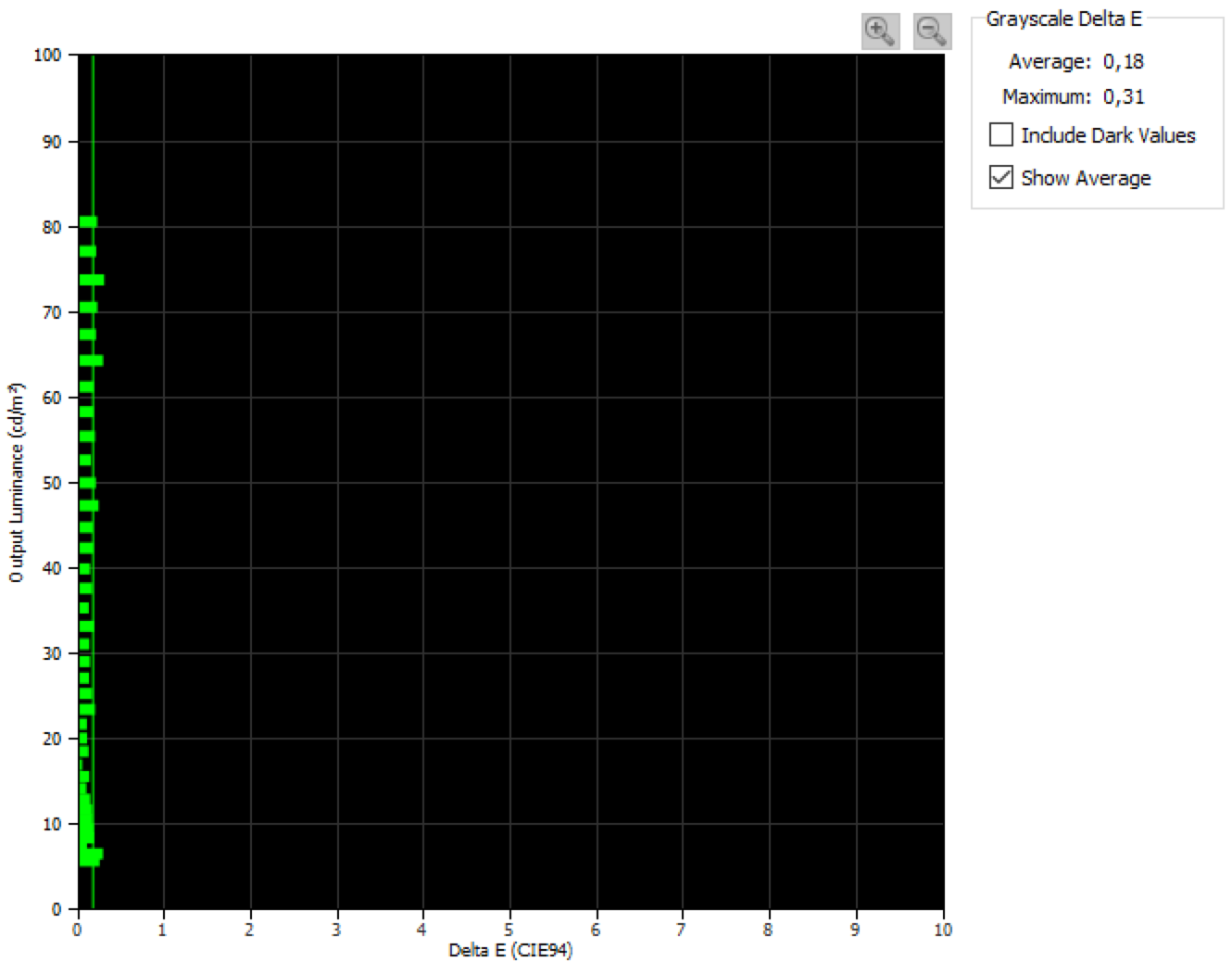

NEC PA271Q - wstępne wrażenia
Ad. 1 Monitor był kalibrowany do specyficznych zastosowań, stąd wyższy punkt czerni. Normalnie czerń ma znacznie niższą, kontrast znamionowy ok 1000-1100:1.
Ad. 2 Pomyłka walidacji wynika z braku korekcji widmowej luminoforu PFS tego konkretnie typu matrycy w programie ArgyllCMS. Błąd jest tylko interpretacyjny, bowiem zapisana kalibracja jest mierzona z korekcją.
Calbration is broken in that PA271Q. That one is a totally useless monitor, I would return it for refund untill I get a PA271Q that works... and that one is not working as expected for a monitor of its price.
Look at those a* errors from a*=0, that gives you an a* range over 1.x an this is only in green-magenta axis. TOTALLY UNACEPTABLE.
ArgyllCMS has EXACTLY the proper correction for this monitor..,. and it is the one you used: HP Deramcolor Z24x G2 (1nm resolution)
If you integrate SPD of each channel multiplyed by standard observer you get almost full AdobeRGB and very high P3 (bigger than GB-LED) and it is exacly what a PA271Q is
(3nm or maybe 5nm resolution from chiphell)
(10nm resolution from ChipHell)
ArgyllCMS & DisplayCAL can measure a PA271Q out of the box with an i1d3 colorimeter using bundled corrections ( http://displaycal.net/i1d3 ). In fact... you won't be able to measure it more accurately with an i1Pro2 spectrophotometer as we see in 3nm and 10nm resolution plots.
The problem is in NEC Spectraview II 1.1.39 that still has no WLED PFS (AdobeRGB flavor) correction... and that is NEC's fault.
(also there is that issue with Spectraview Engine not working as expected)
Some PA271Q have SEVERE issues, unaceptable IMHO. I would not buy them unless store guarantees that if Spectraview Engine ("factory calibration" + engine for modifying calibration target) or Spectraview II do not work properly they are going to return your money tou you.
Otherwise get a old & tested CS2730 with its lut-matrix & 1000:1 contrast ratio.... or try luck with W-LED PFS from Eizo and their CGs. They are more expensive.

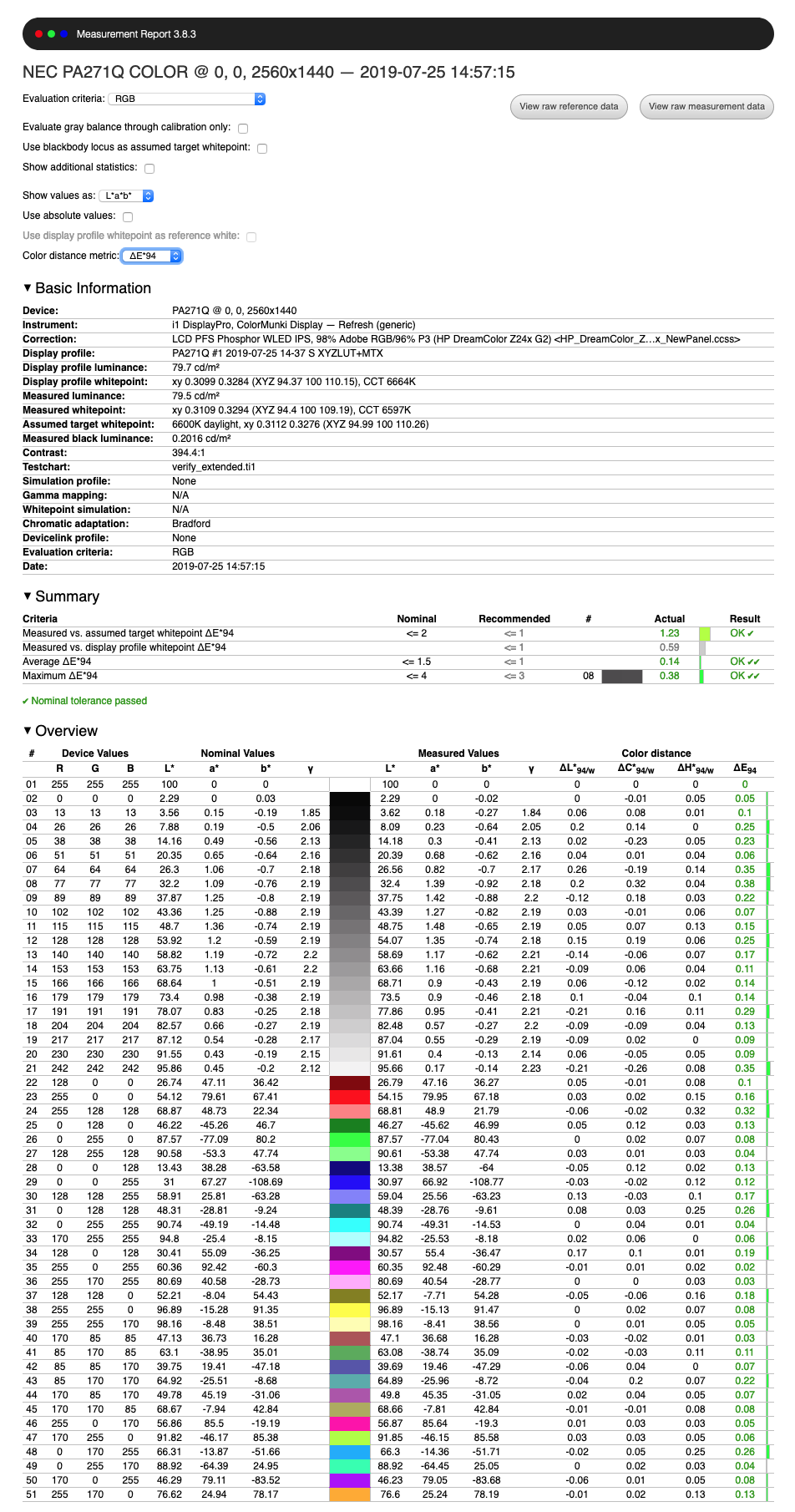

-there is variation across magenta--green axis in greys, which is very bad for B&W work.
-error (deltaE/deltaC, etc) is very low because profile stores that deviation in TRC curves. Monitor grey and the "not good" grey that profile stores MATCH (profile & monitor match)
By default a Profile verification in DisplayCAL validates if profile & monitor match. If you want to see actual errors in a*b* axis (ignoring gamma brightness error) then click in combo box "evaluate gray balance through calibration only". If that option is active reference a* & b* values are 0 (and reference L* if display itselft).
-Profiles with 1 TRC or equal TRC curves have a=b=0 by default (NEC software AFAIK, ColorNavigator, i1Profile variant with "matrix profiles" etc).
-Profiles with 3 TRC like some matrix profiles in DisplauyCAL or "table" profiles in i1Profiler & variants, or XYZLUT profiles in Displaycal may not have a=b=0 for grey reference.
With 1 HTML report you can verify all these issues.
There are other check boxes like you see in Tom01 example:
download/file.php?id=2048&mode=view
"Aditional statistics" is useful to see if it is a GPU calibration because unique grel levels will be under 100%. That does not mean that there will be steps or bands in non color managed gradients becasue some GPUs use dithering at their outputs
"Use absolute values" is more complex to explain... By default verifications are done in transformed colorspace, PCS, profile conection space, a "ligua franca" that all profiles know and it is the way applications can transform colors from a profile to other. PCS is a D50 white colorspace, so if you change L*a*b* to xyY coordinates in a D65 calibration you'lls see weird values in xy coordinates of grey: you'll see transformed values to D50.
You can use "absolute value" to see actual xy values (but L*a*b* may be wrong out of PC with a delta B of 20 and delta a about 1, that is the difference between D65 and D50)
Huge b* variations are common in cheap Rec709/sRGB LED TVs
If a*/b* errors in verification were almost 0, there can be banding in gradients and green-magenta cast in greys because of 8bit correction in LUTs (rounding errors) if you calibrate in graphics card. For that situations if youcalibrate in graphics card, you need a visual inspection of a NON COLOR MANAGED gradient, like lagom lcd gradent test in MS paint.
NEC validation with their own software validates deltaE errors. That is brightness error (L*), a* error and b* error in ONE VALUE.
A deltaE of 2 cal be gamma error (brightness) or a magenta cast in grey. So you cannot trust it. Same for i1Profiler deltaE.
-Basicolor limited verification showed a*b* errors but there was no "visual" way to evaluate how severe it was, since it was done in deltaE.
-DisplayCAL can be used to do that in a more detailed way.
Future software or newer versions of existing oen may incorporate that a*b* verification for greys.
Is this a brightness error (gamma) or a color cast in greys?
download/file.php?id=2044
With that graph we do not know.
Ye. Look at Tom01 report because it is very good as example:

Vicent,
Everything starts to be more clear
Many thanks for sharing knowledge and experience.
Returning to PA271Q.
Based on your comment, Tom has chosen right color correction in DisplayCal, but still got these relatively big errors for grey patches (v.s. expectations).
1. Could it mean that PA271Q has bigger problem than it was assumed and maybe that is the reason of non existing fix?
2. And good results for this "prepared for specific conditions" PA271Q are just good because are read after profile was applied?
What is your opinion?
BTW. Still - with Radeon + GPU lut + profiling, results can be great for PA271Q but..... I have "old" EIZO S2243W and got results as in attached file - yes they are worse but truly said I expected better results from PA271Q. I do not claim s2243W is better - in fact it is terrible in terms of uniformity (green cast on left and magenta cast on right) and that is why I thought of buying PA271Q. But now, it looks that it is better to wait.....

RGB gray balance (>= 1% luminance) combined Δa*00 and Δb*00 range 2.05 NOT OK
GREY 64 1.08 delta a (pink)
GREY 115 -0.75 delta a (green)
Recalibrate using the slowest speed (12, 24, 48 then 96 steps in grey calibration). It's about 30-40 min in with a i1displaypro and black level about 0.15cd/m2 (it may be slower with barker black point)
Kod: Zaznacz cały
2. And good results for this "prepared for specific conditions" PA271Q are just good because are read after profile was applied?a ) Was it generated with Spectraview II?
One of the possible causes is a low quality panel which when uncalibrated has those tints/waves in a* axis.
SpectraviewII does not seem to take 96 x 4 (RGBW) like Argyll to do a full grayscale correction (like a physiotherapist when you have a muscle injury) since one would expect that NEC panels are somehow "preconditioned", with neutral grey. SV2 just takes a reasonable amount of patches for what a NEC display quality would need (actual number is in sv2 manual).
If that is what it happened, we are in a situation similar to DUCCS/PME.

Pozostaje upewnić sie że mówimy o tym samym, aby wykluczyć niedopowiedzenia, tzn.
Czy monitory PA271Q skalibrowane przez Tom01, są SKALIBROWANE SPRZĘTOWO, tzn. że BEZ zaczytania/działania przygotowanego w ramach profilowania przez Tom01 PROFILU i bez wczytania korekty do karty graficznej będą rzeczywiście skalibrowane (piekny szary gradient bez zafarbów i o zadanej gammie).
Oczywiście, że sprzętowo. Tylko i wyłącznie.
Czyli po zresetowniu krzywych w karcie graficznej i raport kalibracji z Argylla (Report on uncalibrated display device) wykaże praktycznie zerowe odchyłki delta a i delta b dla szarych próbek?
Dzieki - w pytaniu byłem precyzjny, ale jak widzę kręcimy się w kółko w tym wątku odpowiadając na inne pytania niż zadane - jak w polityce
Chodziło konkretnie o delta a i delta b z dokładnie takiego raportu z Argylla (nie innego, nie inne wykresy, nie inne tabelki, nie inne programy itp.) - takiego raportu jak ten
viewtopic.php?f=31&t=3498&start=1000#p57115
ale z zaznaczoną opcją "Evaluate gray balance through calibration only".
